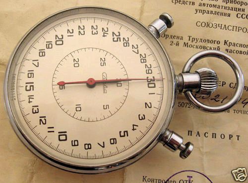

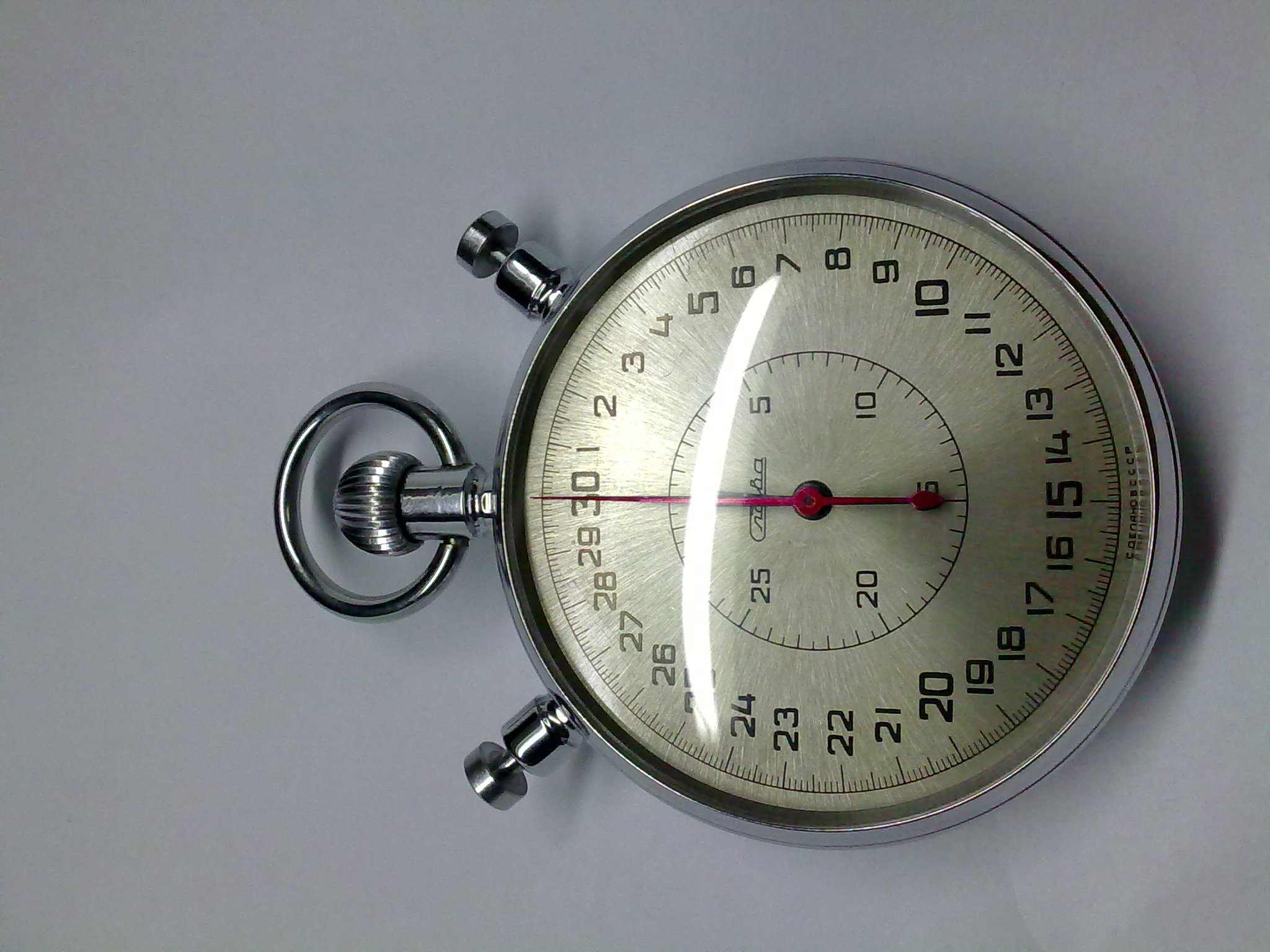

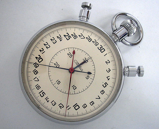

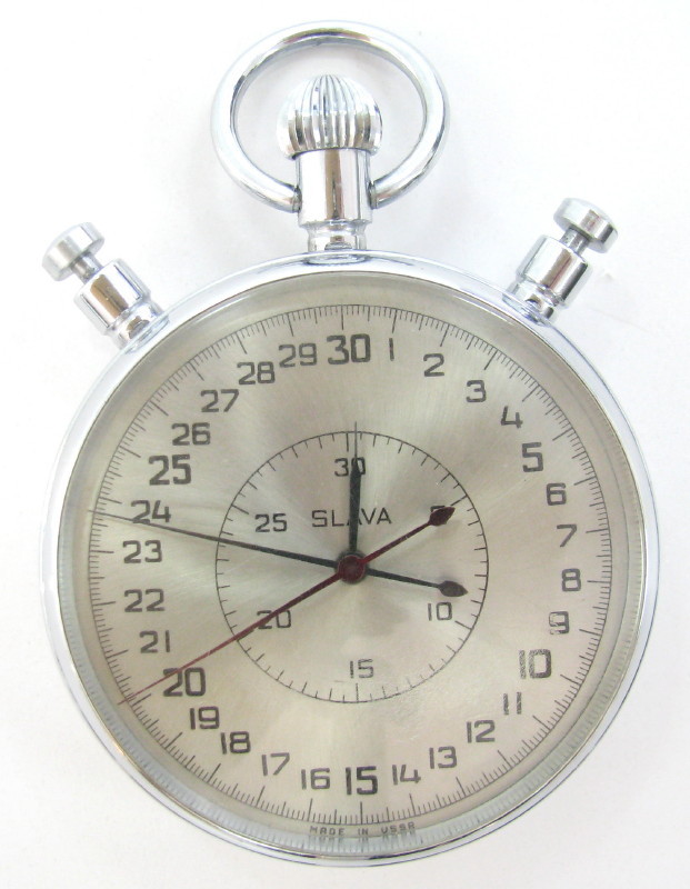

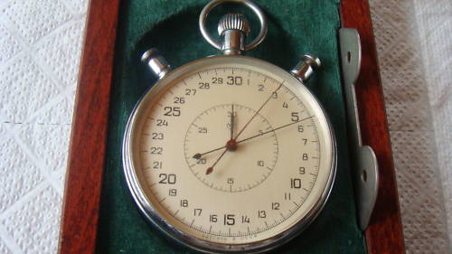

Unfairly little known, the Slava Caliber 5498 is a beautiful and technically impressive 20j split-seconds stopwatch, production of 2-nd Moscow Watch Factory. Caliber 5498 features a central minute counter, a plain (or screwed) balance running at 36,000 bph, breguet hairspring (with regulator). Icing on the cake, the rattrapante function (split-seconds) is based on a column wheel.
Andrew Babanin is a well-known master watchmaker in Moscow. He is very active in spreading his first-hand knowledge about russian watchmaking. But when asked for some information about caliber 5498, he replied:
I know that there was a lab at the factory, where approx 20 watchmakers assembled these stop watches. Unfortunately, there is really not so much info about such interesting caliber.
I've already gathered some information about it at orologiko.it in italian. Here are some pictures about this horological marvel.
Note: All pictures have been collected over the internet, except where explicitly noted. I've tried to preserve the original information (e.g. exif data) to explicitly credit original authors.

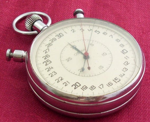

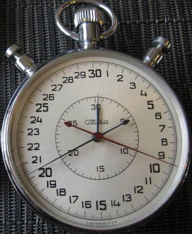

Variations on a Theme
This watch has been in production for 30+ years. However, there seem to be very few differences among all the samples I've seen. Here's a brief list of what I've found.

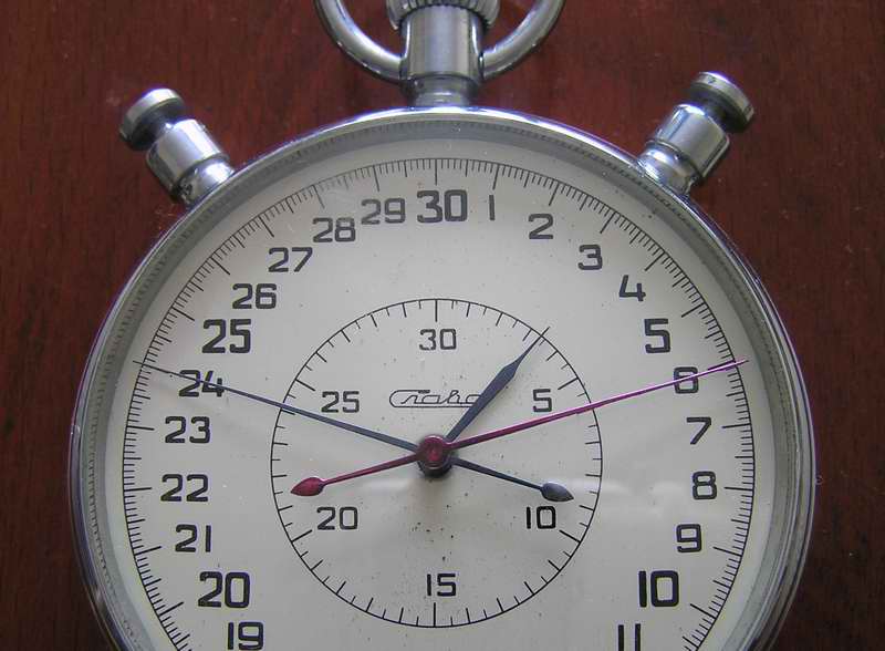

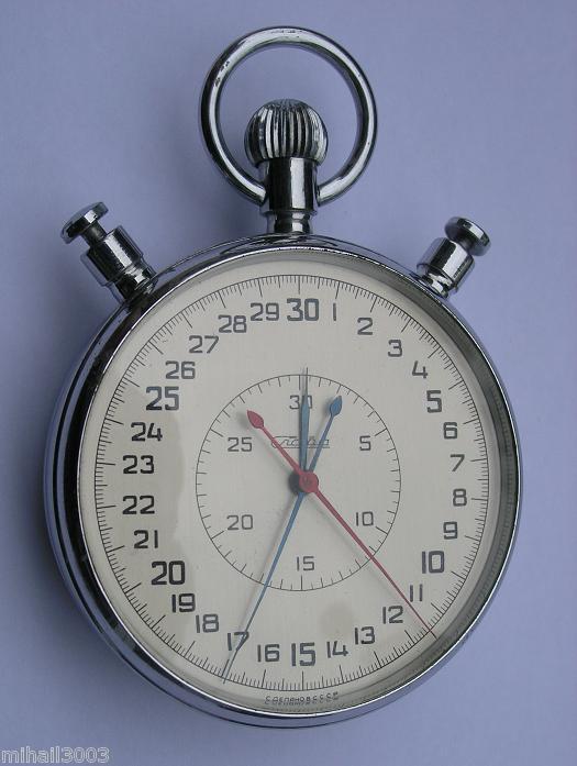

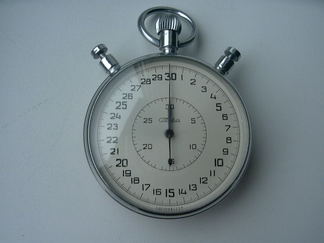

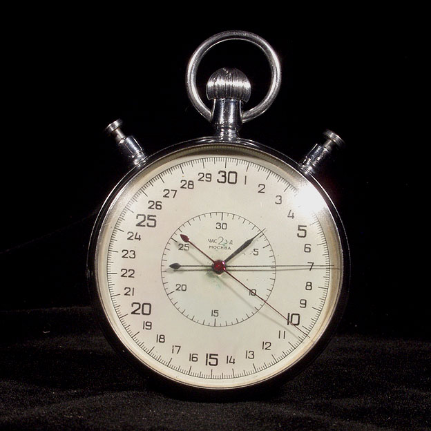

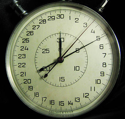

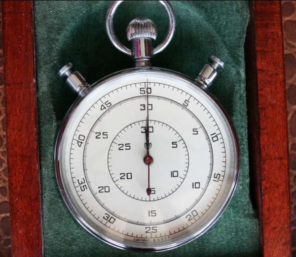

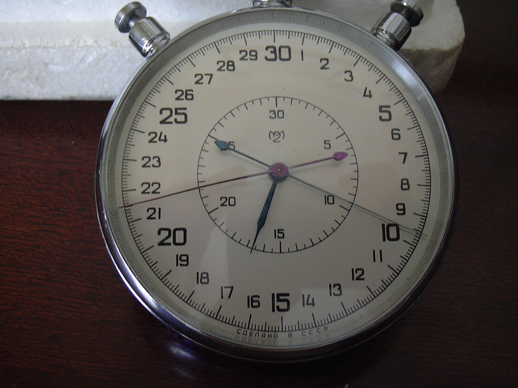

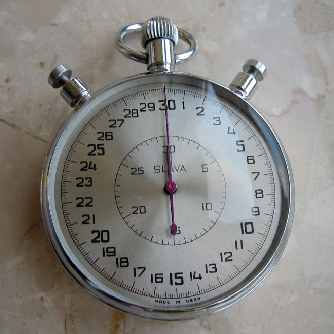

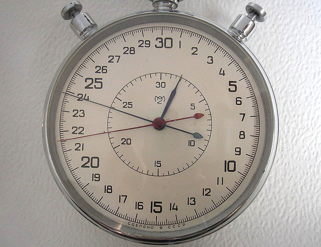

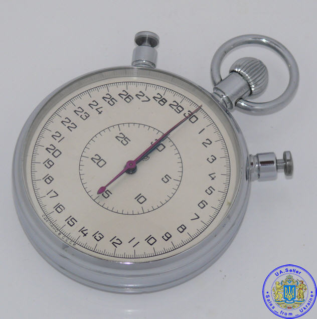

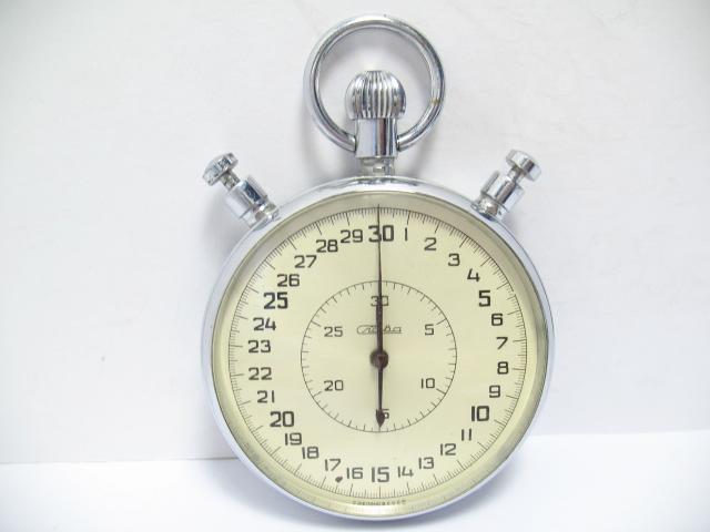

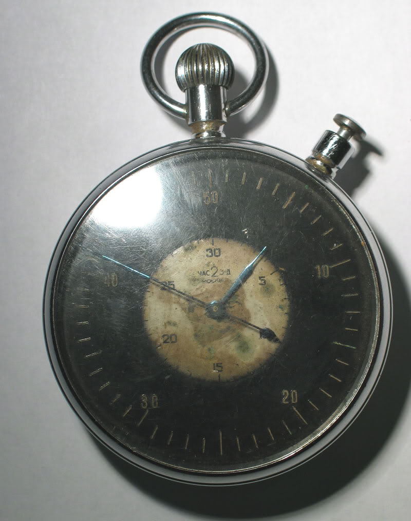

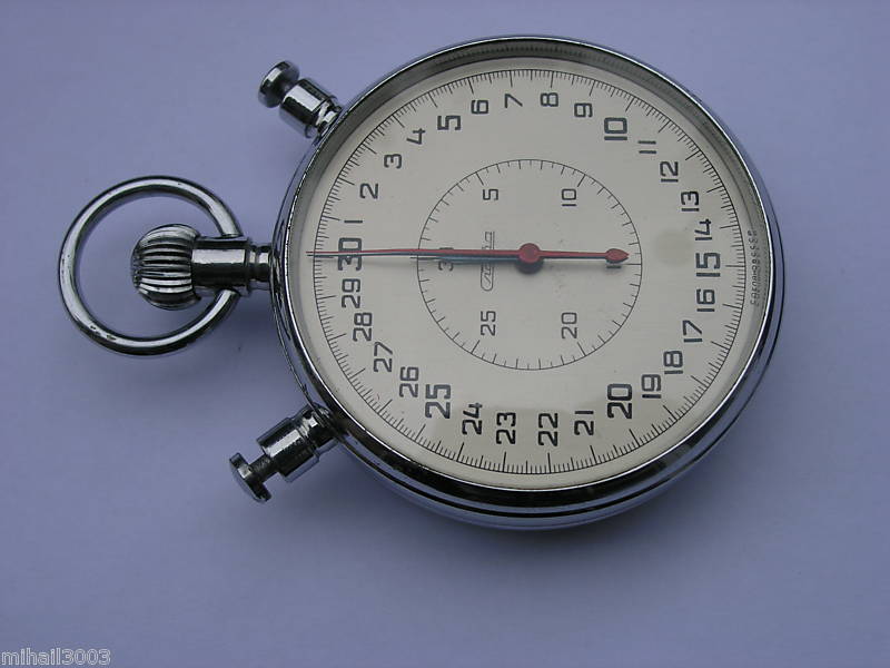

Dial variations:
The outer numerals (seconds) are usually bold at 5 seconds intervals (5, 10, etc), however
samples have been found with 'flat', unbold, numerals.

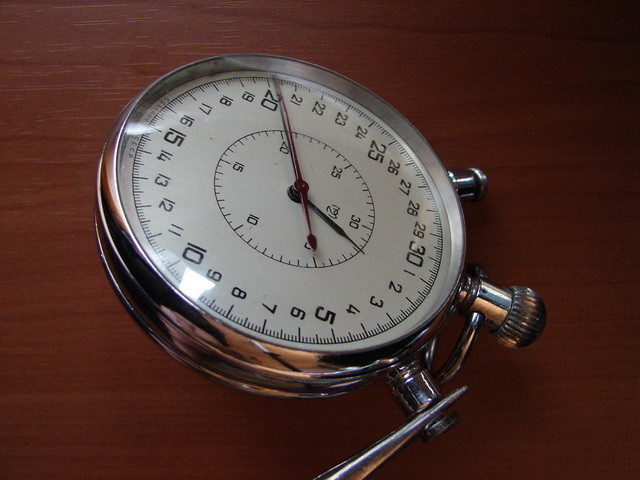

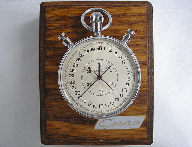

The most obvious difference is in the logo, placed just below numeral '30'
inside the inner minute ring:

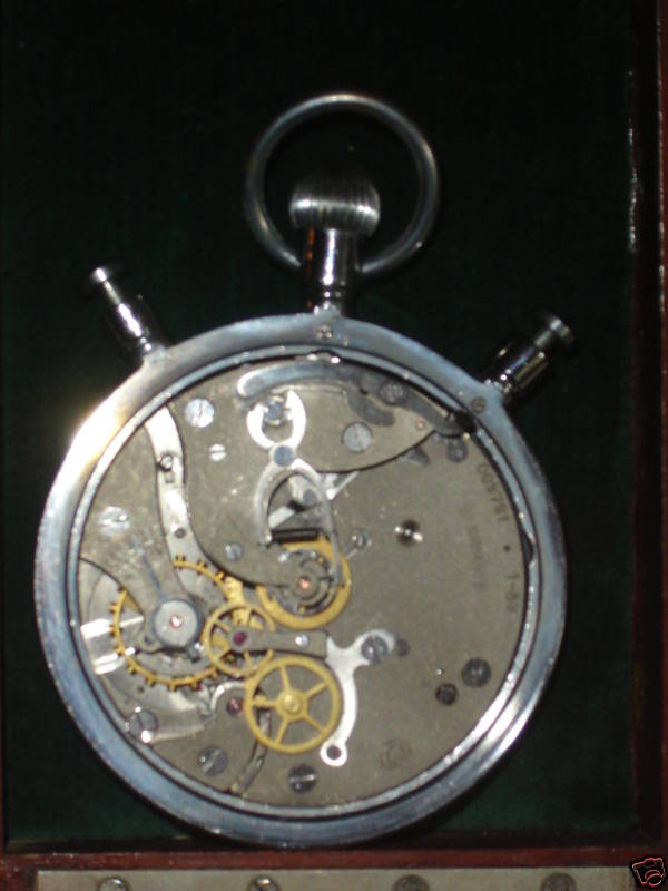

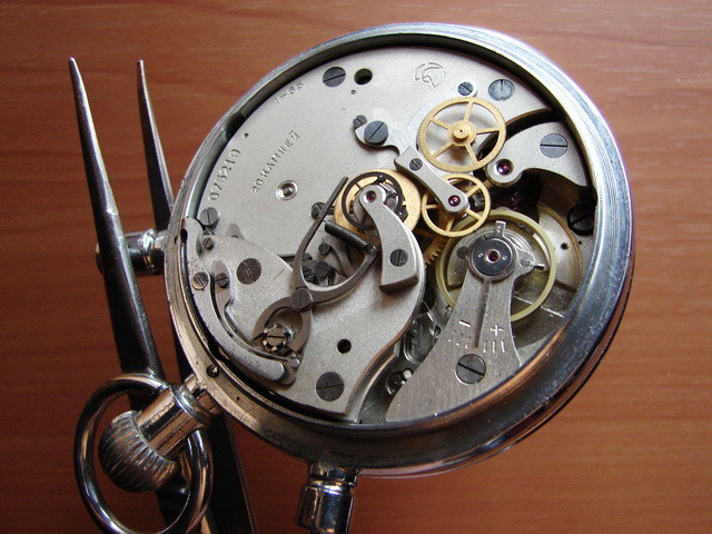

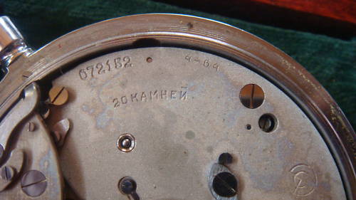

Serial Number (S/N) variations: Unlike most soviet watch factories, 2MWF serial numbers are quite easy to understand. They simply used to engrave a progressive, 6-digits, unique number on any movement. In the mid '50s the counter was reset, still retaining 6-digits. However, stopwatches production started shortly thereafter, so there's no risk of ambiguity. In 1973 the counter was reset for the last time, but this time grown to 7-digits thus eliminating any ambiguity once again. Just keep an eye on how many digits are there in your S/N, model #012345 may be several years older than model #0012345.

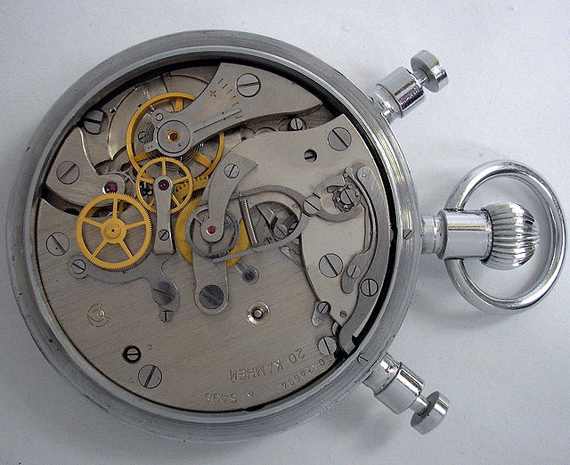

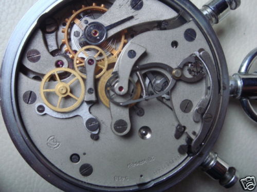

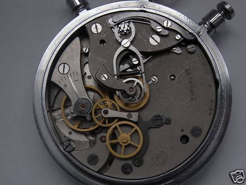

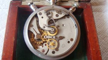

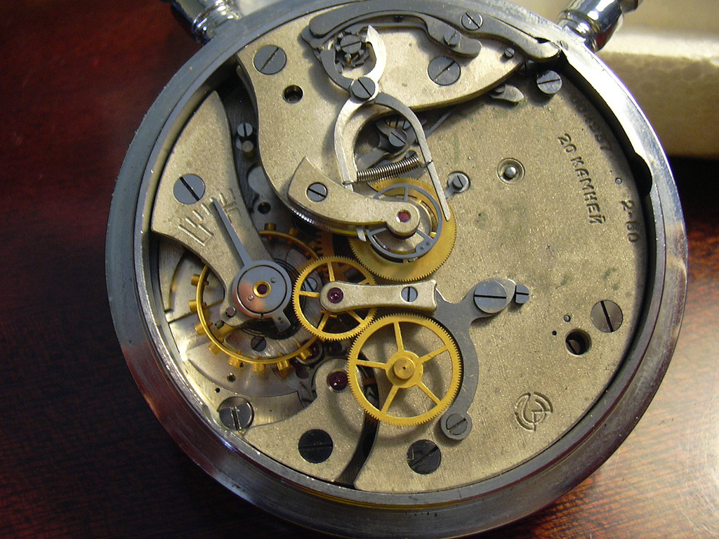

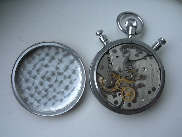

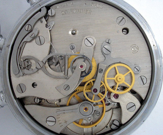

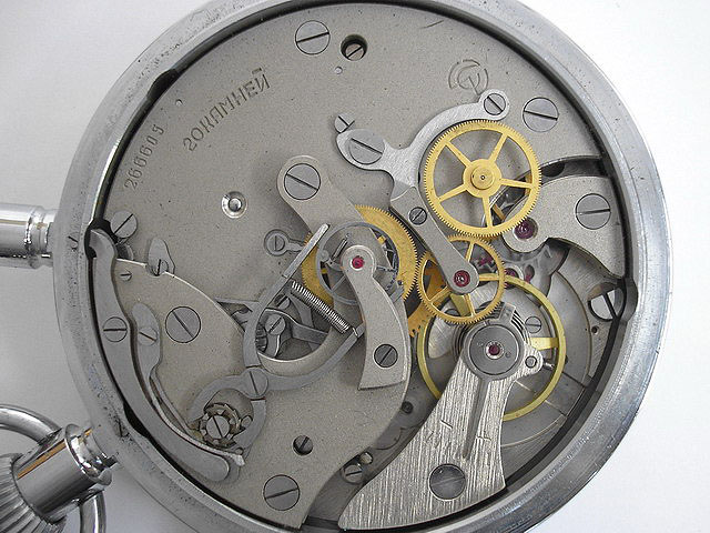

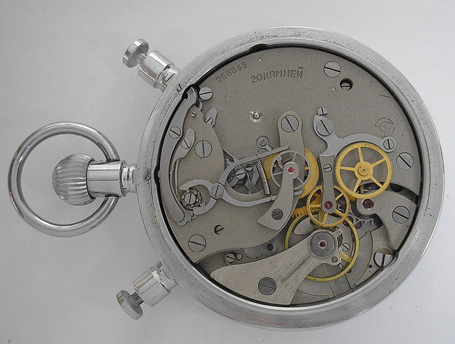

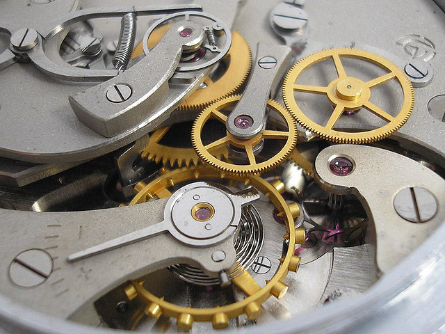

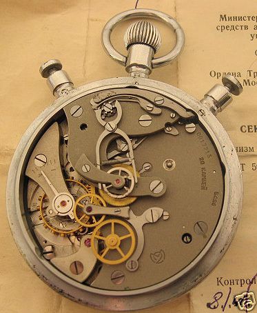

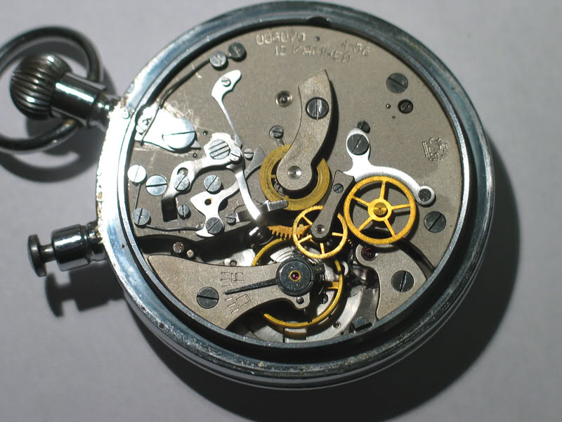

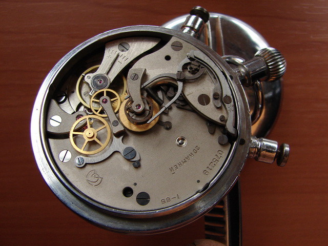

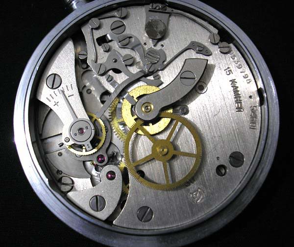

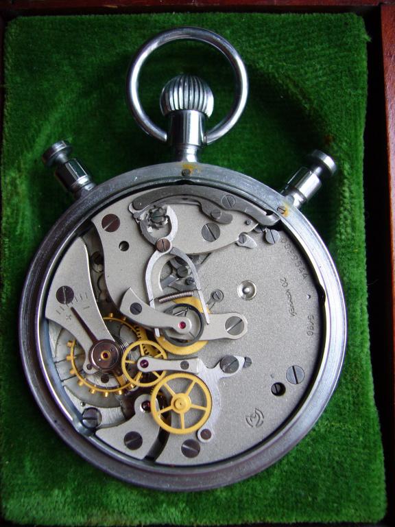

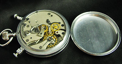

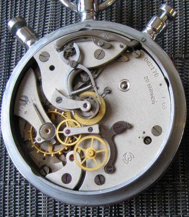

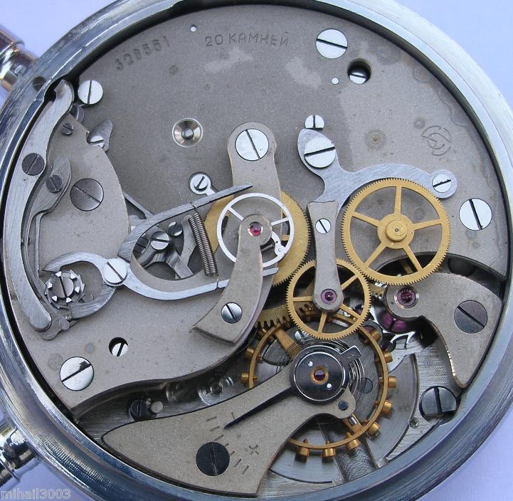

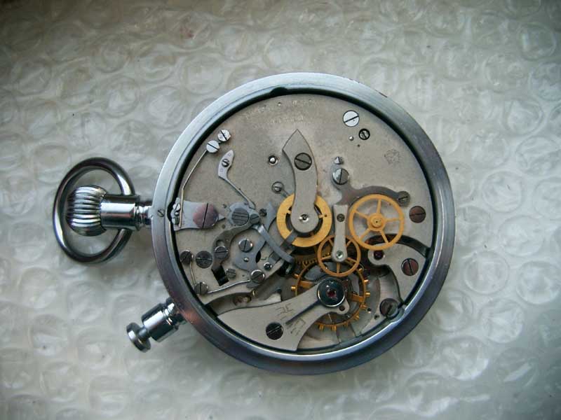

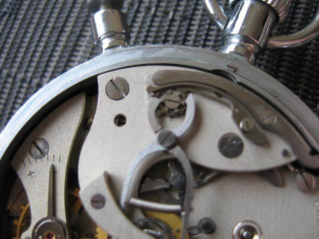

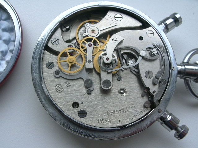

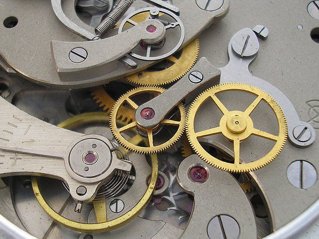

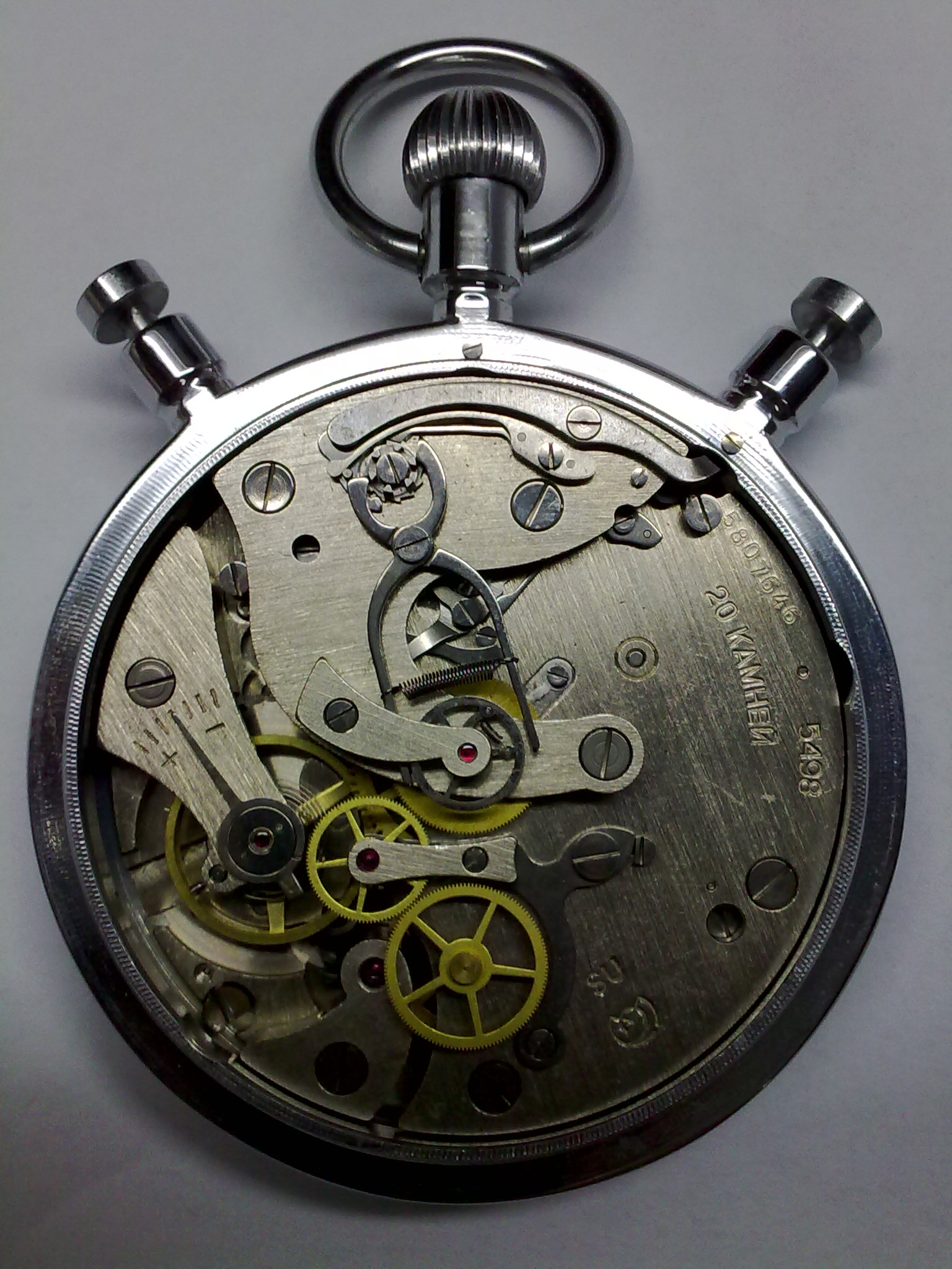

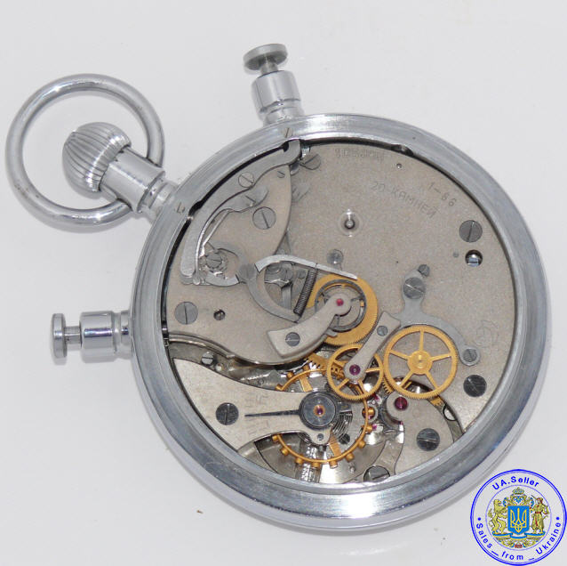

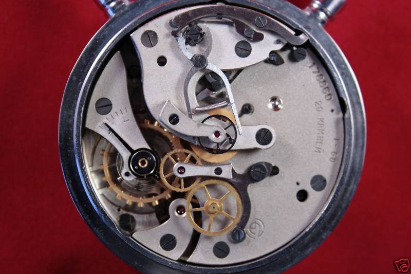

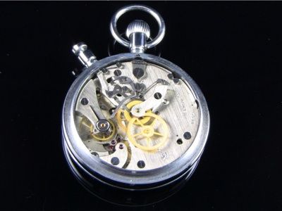

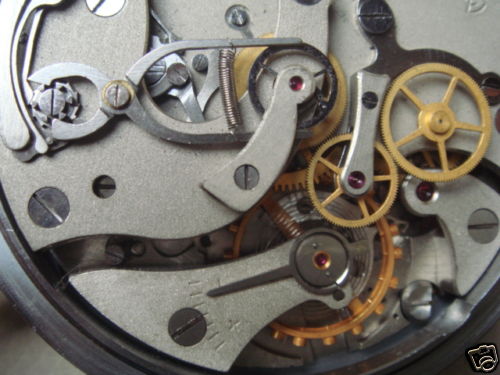

Movement variations: As far as I know, this is the only part evidently changed throughout the years:
It's the plate holding the chronograph mechanism, which was given a broader surface and an additional screw. The one shown above is the new plate, part no.8281, appeared around 1969. (get part list here)

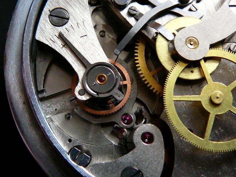

Another minor change occurred in 1973, when the former beautiful screwed balance wheel was replaced by a more functional smooth one. Due to the lack of an anti-shock device - and plenty of spare parts available - it is likely that the whole balance were replaced whenever the staff broke, possibly exchanging screwed and smooth ones without caring too much.
Other more subtle variations are found in the inscriptions. All movements are signed with the 2M logo in the lower/right side (sometimes upside-down). Samples could be found where the logo is surmounted by the letters SU (Soviet Union) possibly indicating an export version. On the right side the serial number is always present, as well as "20 камней" i.e. 20 jewels. On the right side of the serial number we may found:

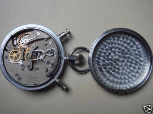

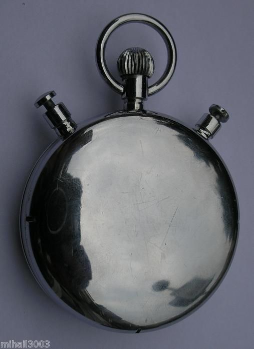

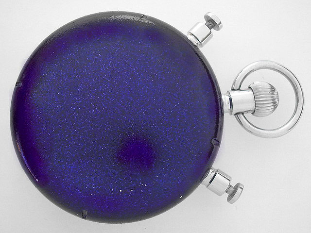

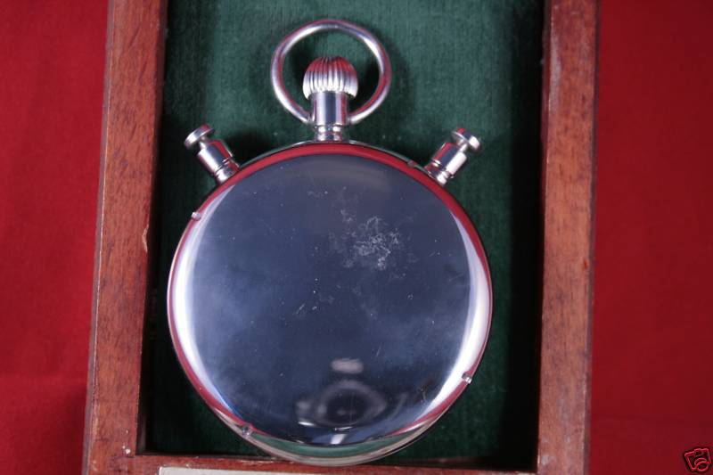

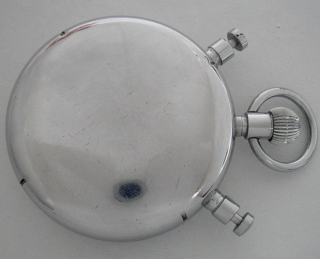

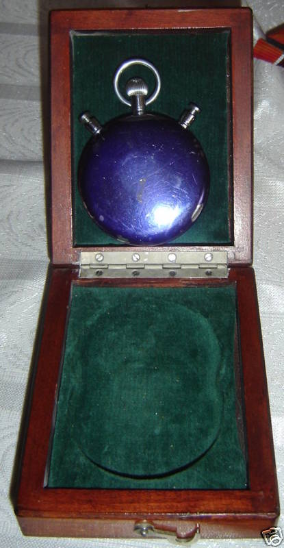

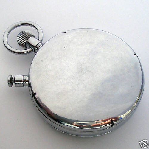

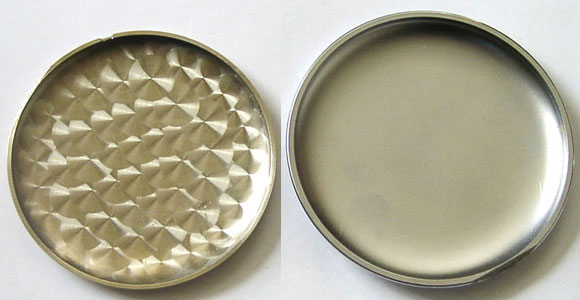

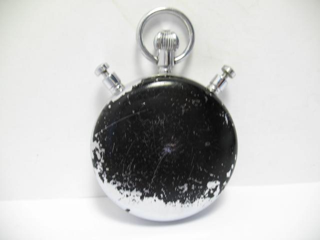

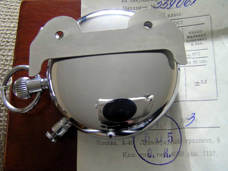

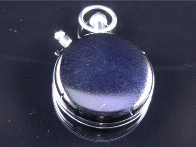

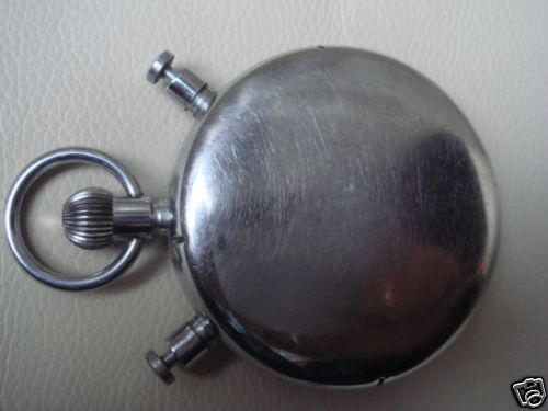

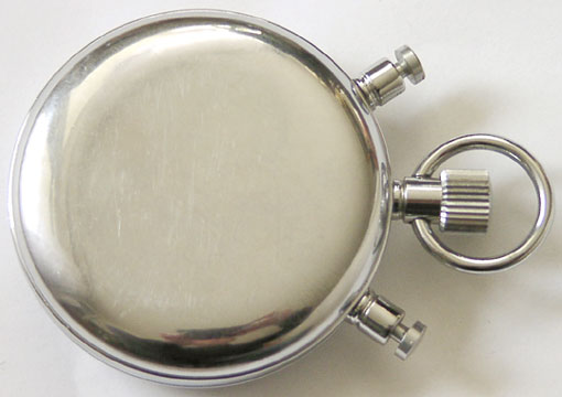

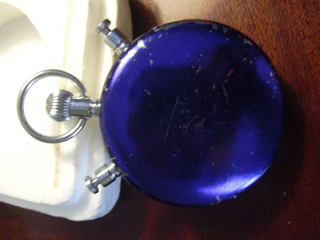

Caseback variations: According to russian fellows at watch.ru, the protective film comes in various colors: blue, black, yellow, transparent and even red. Its intended purpose is to prevent chromium plating oxidation due to sweat of the hands. Apparently the paint is very prone to peeling, and is partly or completely missing in most of the stopwatches found. I've seen casebacks intentionally polished, maybe to remove aestethically unpleasant paint residuals, as well as evidently repainted ones, maybe to hide a flaw or two. The inner side may be polished or perlaged.

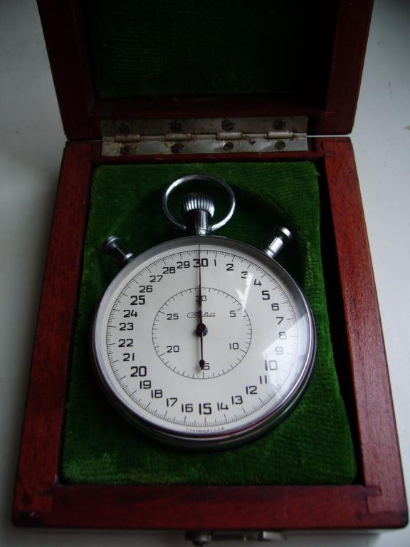

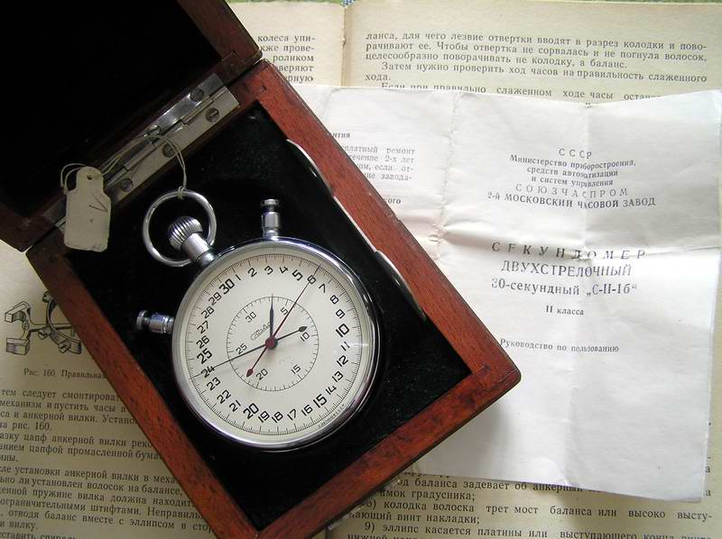

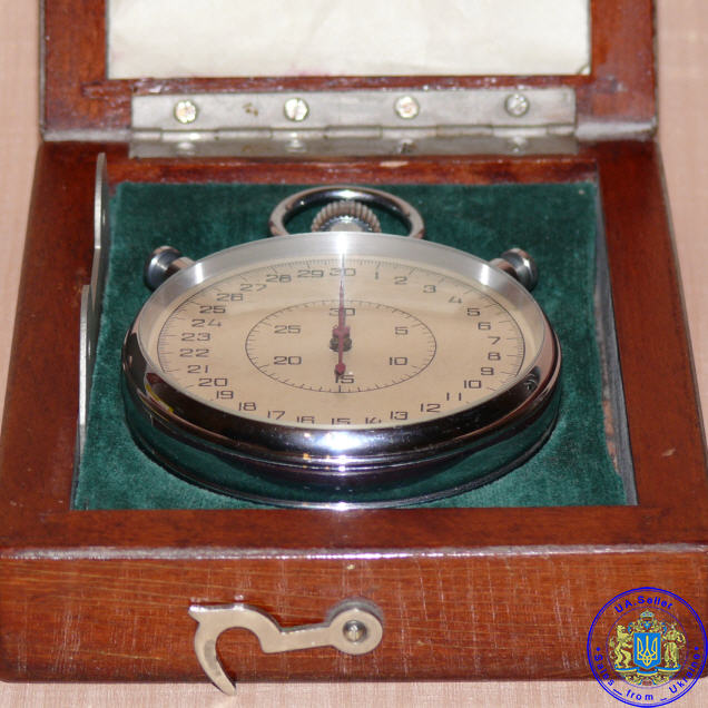

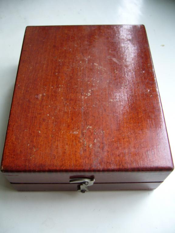

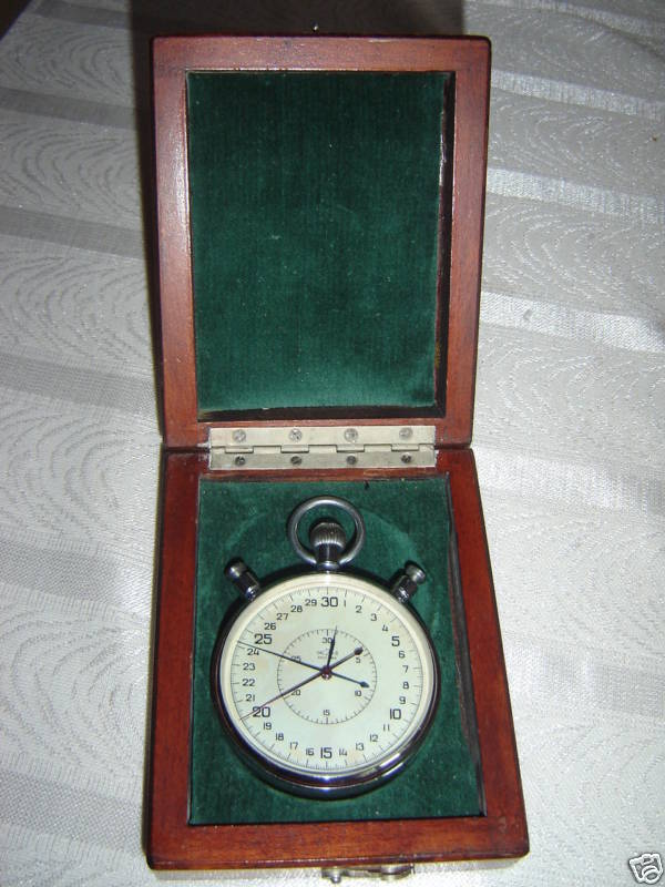

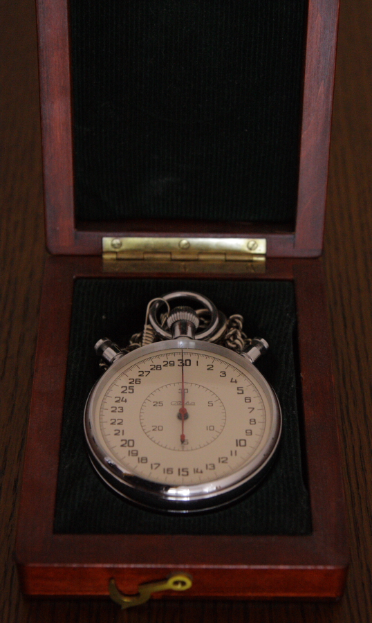

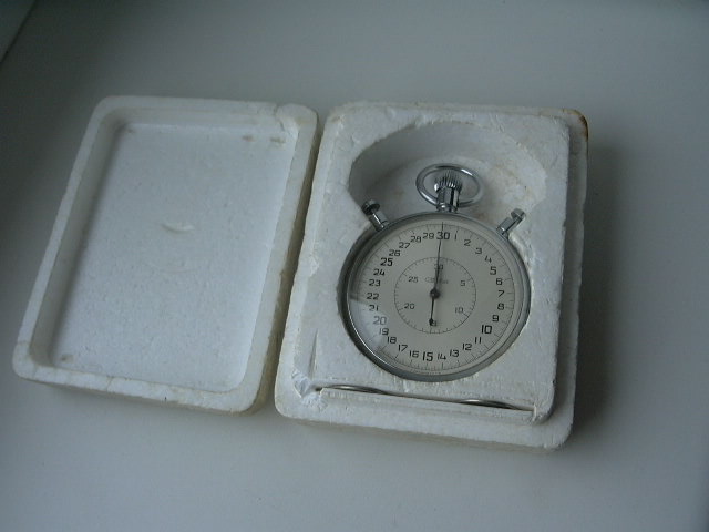

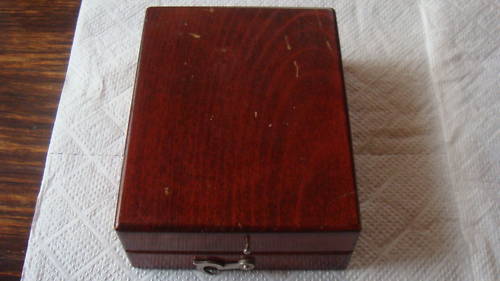

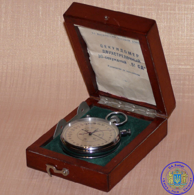

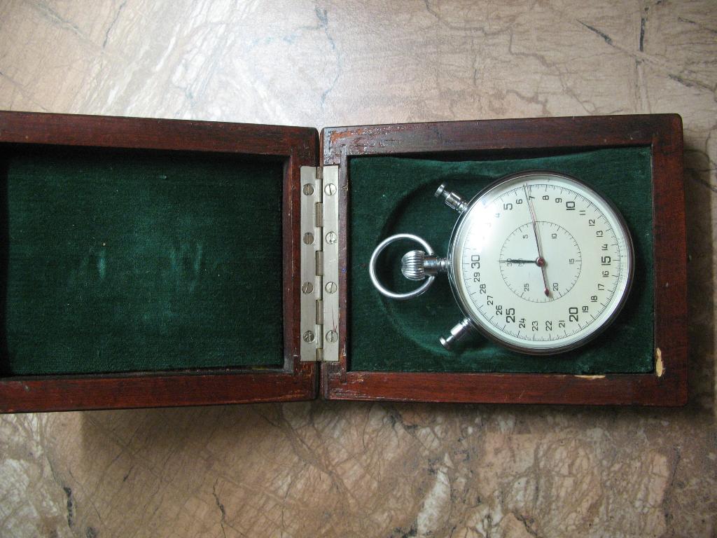

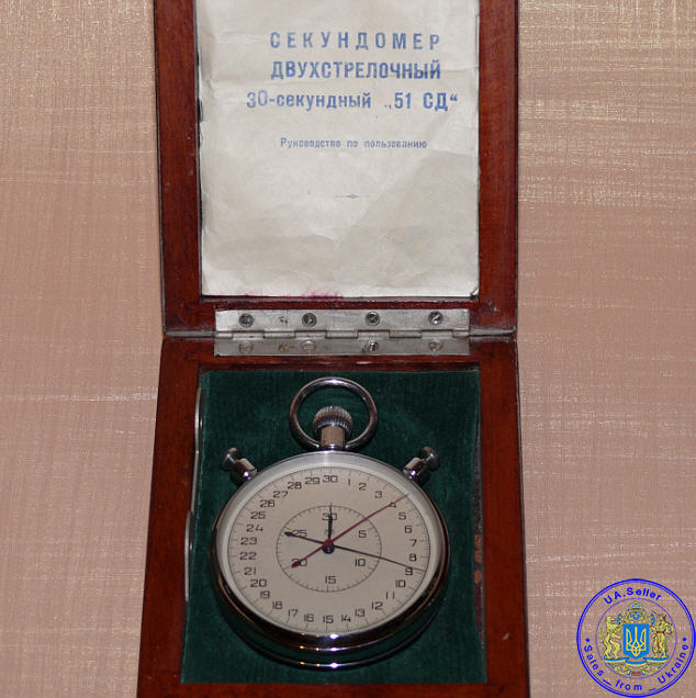

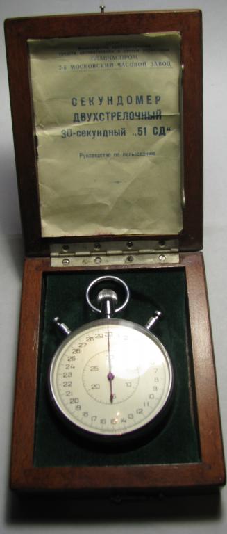

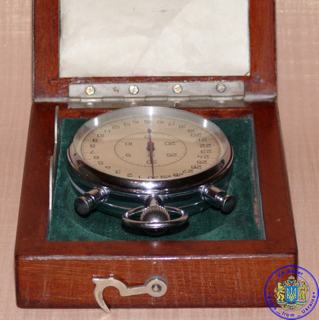

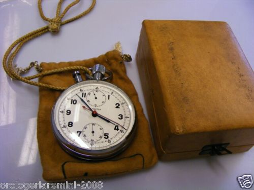

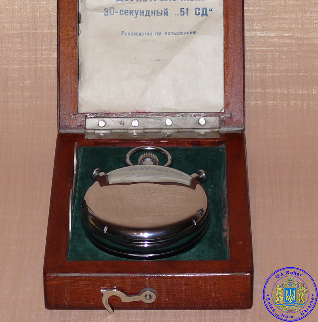

Packaging variations: Some models came with a simple wooden box with a green cloth inside, some with an expanded polystyrene foam box. User's manual and a caseback opener are always part of the bundle. Be very careful if you plan to use the case opener, it's very easy to scratch the caseback.

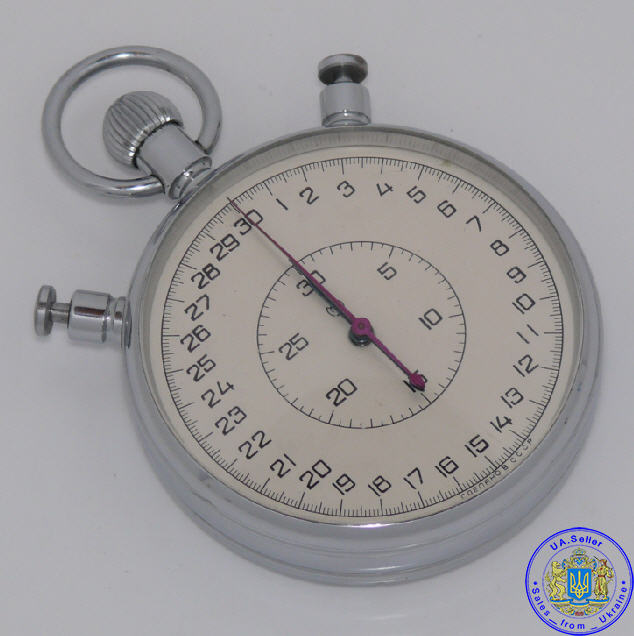

Former Models

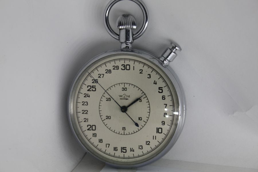

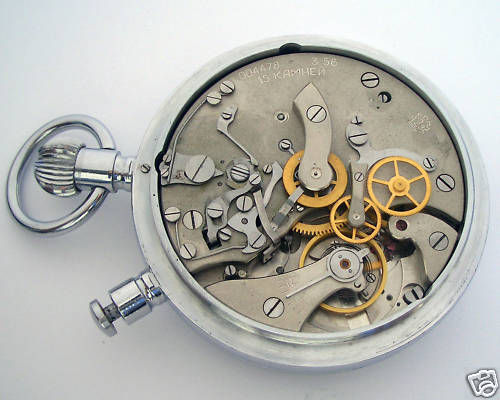

Year: 1954, S/N: ---, 15 jewels
"Rare stopwatch 2 MWF", screw balance
Year: 3Q-1956, S/N: 004478, 15 jewels
eBay Ukraine, "Rare USSR Sport Stopwatch SLAVA 2 MChZ", smooth balance
Year: 3Q-1956, S/N: 004643, 15 jewels
watch.ru "Rare stopwatch 2 MWF", smooth balance

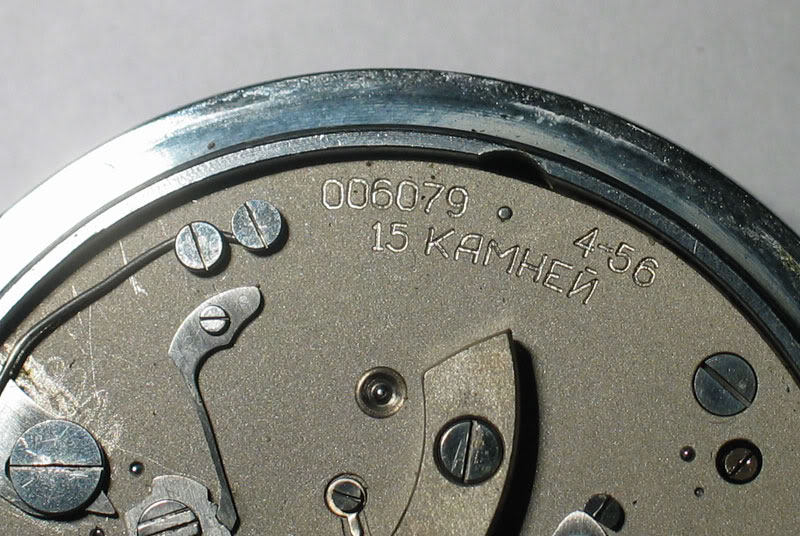

Year: 4Q-1956, S/N: 006079, 15 jewels
"Rare stopwatch 2 MWF" featuring 50 tickmarks, smooth balance (possibly replaced). Interesting sample found at watch.ru.
ArchiveYear: 1Q-1959, S/N: 009400
| Dial | : | час2з-д москва |
| Movement | : | - |
| Caseback | : | - |
| Packaging | : | - |
| Notes | : | Mark Gordon's collection |

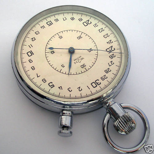

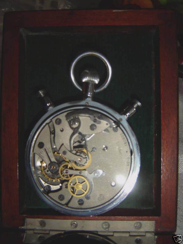

Year: 1Q-1959, S/N: 009791
| Movement | : | s/n + date, screw-balance |

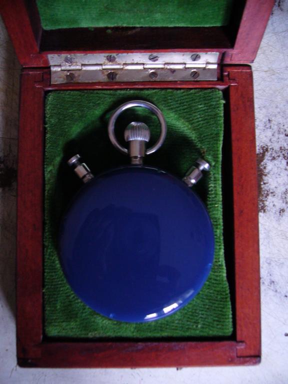

| Caseback | : | painted blue |
| Packaging | : | wooden box |
| Notes | : | eBay Latvia, "Russia USSR Sport Stopwatch MOSKVA Chronometer" |

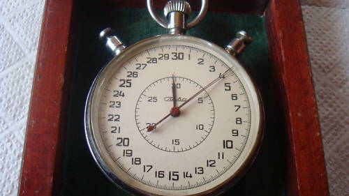

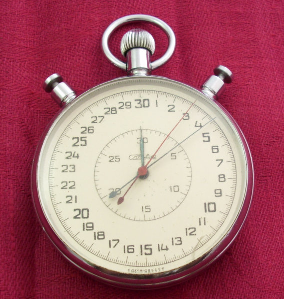

Year: 2Q-1961, S/N: 013065
| Dial | : | Слава |
| Caseback | : | - |
| Notes | : | eBay Germany, possibily redialed |

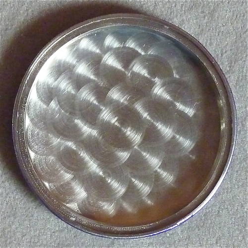

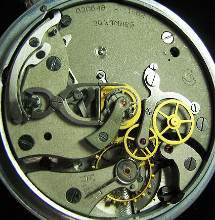

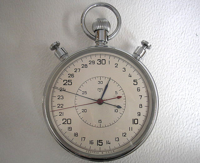

Year: 1Q-1962, S/N: 020648
| Dial | : | 2M logo, "flat" numerals |
| Caseback | : | polished inside |
| Packaging | : | - |
| Notes | : | eBay France |

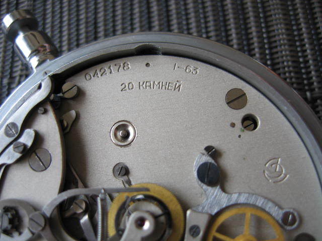

Year: 1Q-1963, S/N: 042178
| Dial | : | Слава |
| Caseback | : | - |
| Packaging | : | - |
| Notes | : | pics by Erik_H at watchuseek.com |

Year: 4Q-1964, S/N: 072152
| Dial | : | 2M logo |

Year: 1Q-1966, S/N: 105805
| Movement | : | s/n + date, screw balance |
| Caseback | : | painted blue, then polished |
| Notes | : | Ukraine |

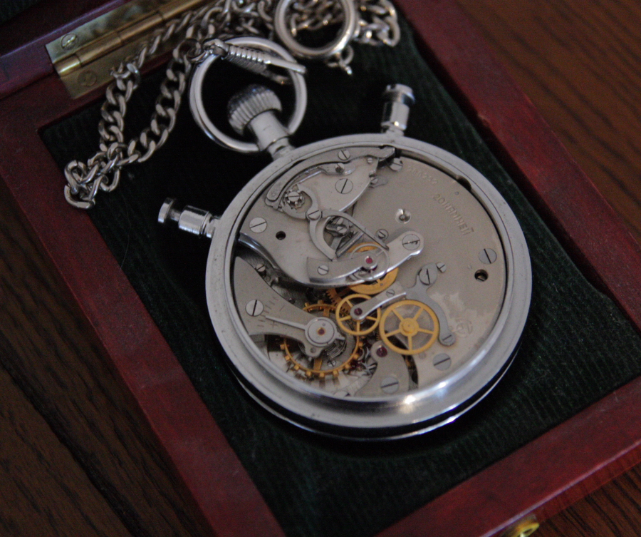

Year: 3Q-1969, S/N: 217569
| Dial | : | Слава |
| Caseback | : | - |

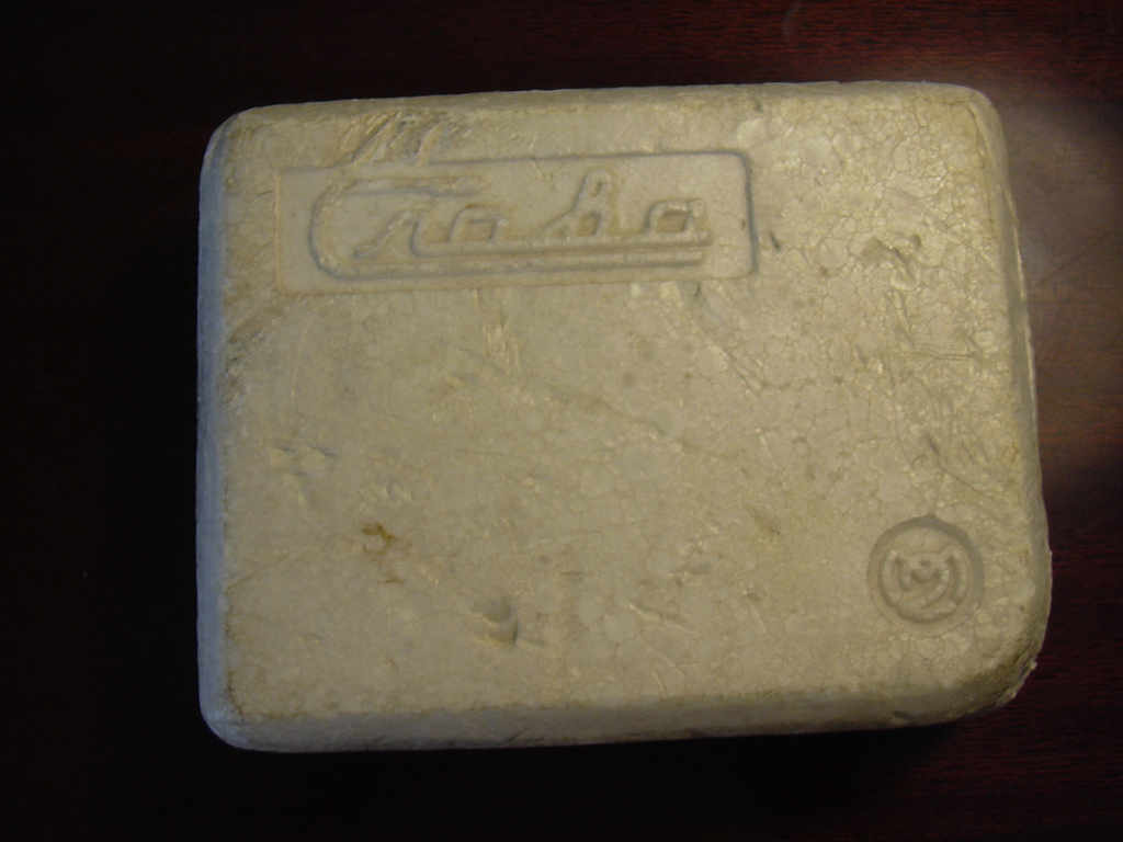

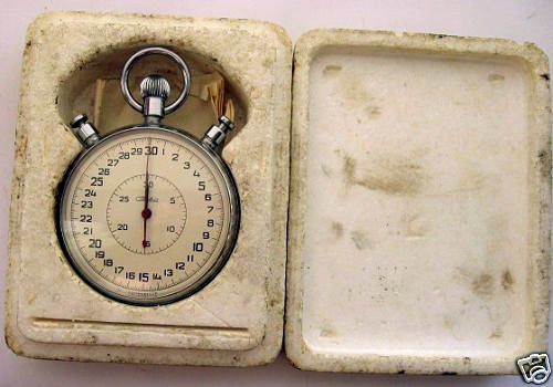

| Packaging | : | expanded polystyrene foam box (the oldest known so far) |
| Notes | : | new plate 8281 for chronograph mechanism (the oldest known so far) |

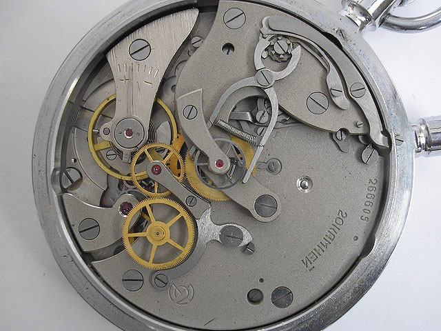

Year: ---, S/N: 266605
| Dial | : | Слава |
| Movement | : | s/n only, smooth balance |
| Packaging | : | aftermarket wooden box |
| Notes | : | eBay Ukraine |

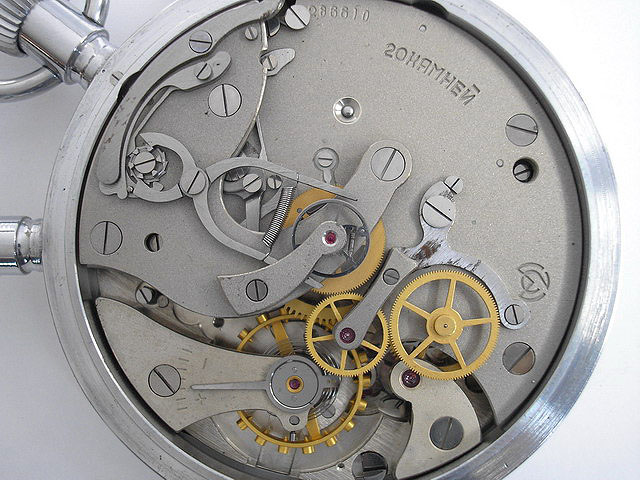

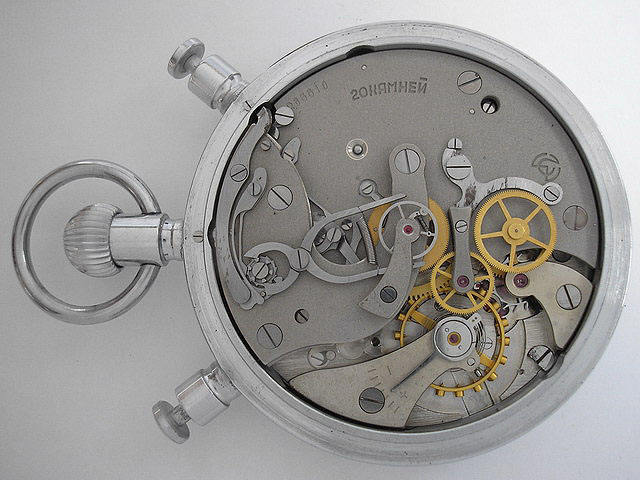

Year: ---, S/N: 266610
Russian Split Sport Chronometer Stopwatch SLAVA
| Dial | : | Слава |
| Movement | : | s/n only, screw balance |

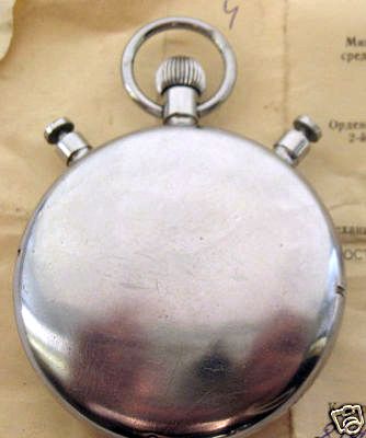

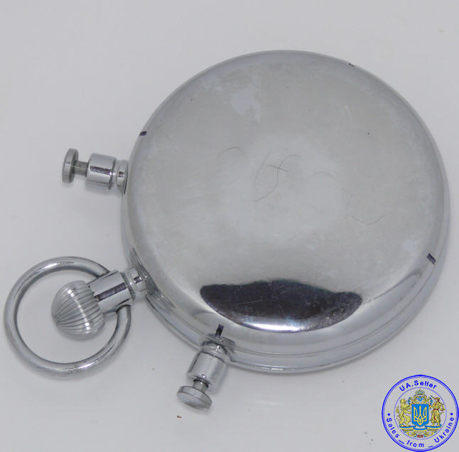

| Caseback | : | polished |

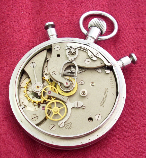

| Packaging | : | - |

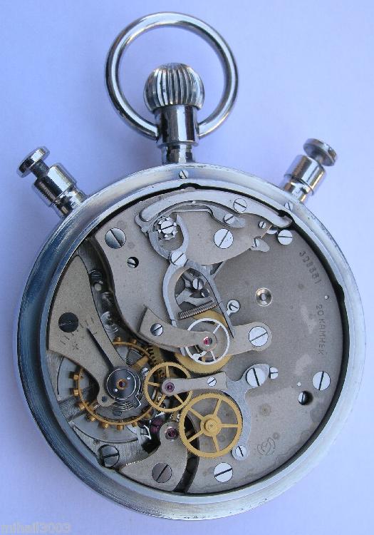

| Notes | : | eBay Ukraine, the chronograph plate has been clearly replaced with the former version. |

Year: ---, S/N: 328561
| Dial | : | Слава |
| Packaging | : | - |
| Notes | : | eBay Bulgaria |

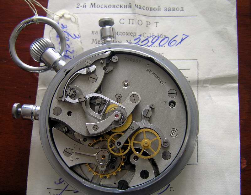

Year: 1973, S/N: 359067
| Dial | : | Слава |
| Notes | : | Private collection, Russia |

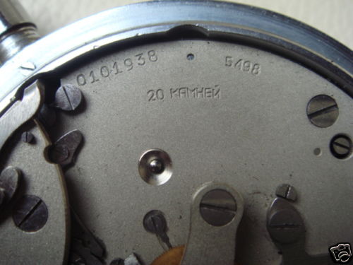

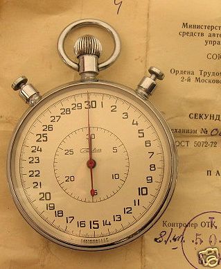

Year: 1974, S/N: 0017213
| Dial | : | Слава |
| Movement | : | s/n + 5498, screw balance |
| Packaging | : | expanded polystyrene foam box |
| Notes | : | eBay Ukraine, GOST 5072-72 |

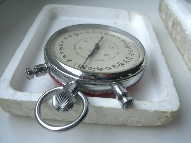

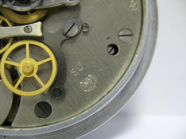

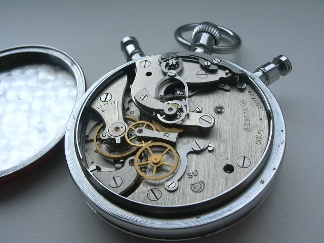

Year: ---, S/N: 0407005
| Dial | : | Слава |
| Movement | : | s/n + 5498, smooth balance, "SU" over 2M logo |

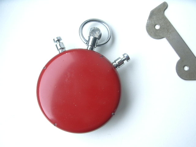

| Caseback | : | painted red |
| Notes | : | Russia |

The exception proves the rule?
So far, all samples have been listed ordered by date. Serial numbers appear to be in some sort of relationship with date, so that we could obtain a rule of thumb to ascertain how old is a sample. But...
Look at this sample from an italian forum. The expanded polystyrene foam box is unusual in 1960. But not impossible. The pasport is clearly after 1979 (GOST 5079-79), but it could be a fake one. The movement is signed 2Q-1960, so the logo should be час2з-д. It's signed 2M instead, but the dial could have been replaced. The serial number 004937, however, doesn't match with 1960. This is something I can't explain.
Maybe "the exception proves the rule." Or to say it with the words of Sherlock Holmes "I never make exceptions. An exception disproves the rule."
Lots of contradictions in this sample. There's no wrong or right answer here. You make the choice.

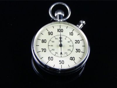

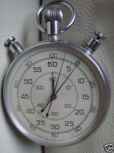

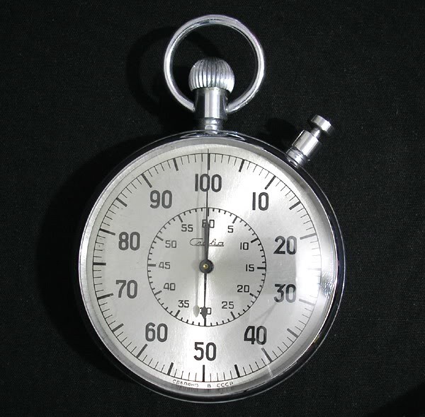

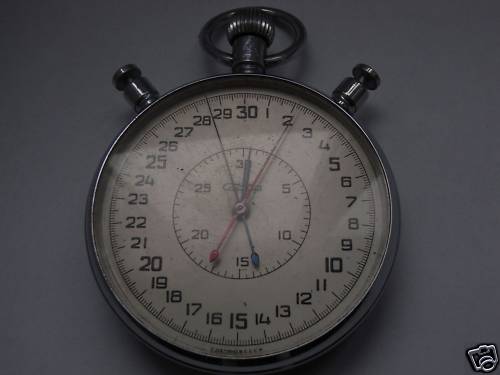

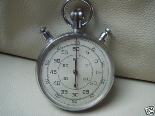

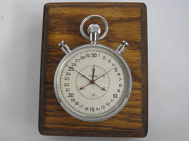

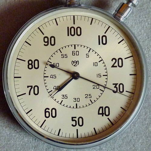

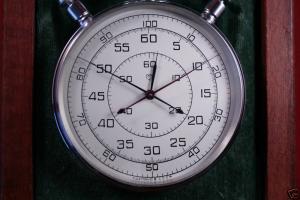

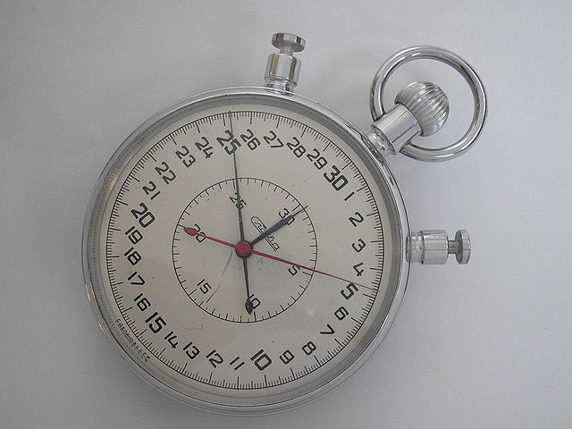

SiblingsSlowhand: 60 min
This is a 60sec./60min. split-seconds stopwatch, running at a more
conventional rate of 18,000 a/h (5 ticks per second). It's interesting to note
that the outer minute scale is divided into 100 parts. This unusual division is
convenient for certain types of industrial timing, which this chronometer
specifically addresses.
Older models feature caliber 5498 (evidently modified to slow it down), more
recent samples are marked 54604. It's not rare, though less spread than
the standard 30min version.
Year: 1Q-1968, S/N: 178860, 2M logo, eBay France.
Year: 1976-1978, S/N: 0101938, sterile dial, movement: modified 5498, eBay Hungary.

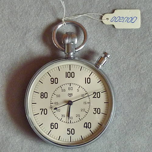

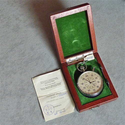

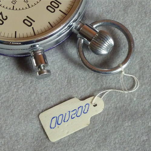

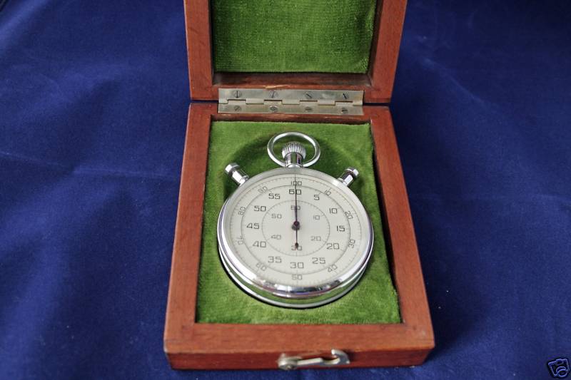

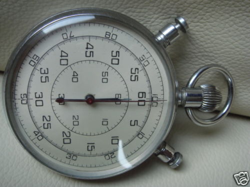

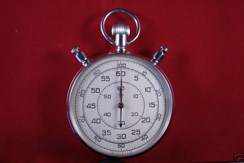

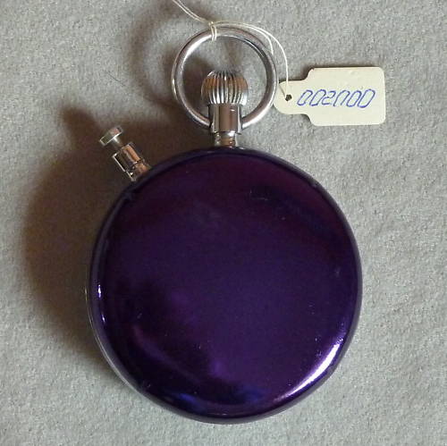

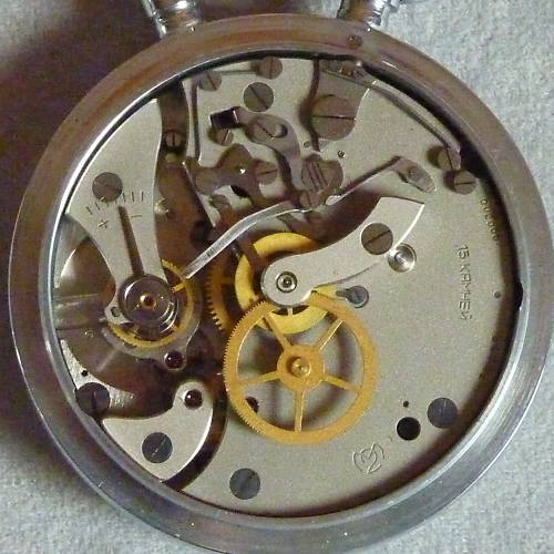

Lightnin' fast!: 1 min (get part list here)

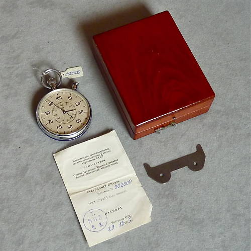

Specifically aimed to athletics timing, this is not the classic rattrapante version, but a simpler 15 jewels, 1/100th second version, without column wheel. The seconds hand performs a complete revolution in one second (there are 100 ticks per second!) and the continuous minute counter in just one minute making it suitable for timing very short competitions. The movement runs astonishingly fast at 360,000 a/h thanks to its very small balance wheel and very strong hairspring. Caliber ХР-I-1, formerly known as 2ХР-1 and later renamed 54601. Difficult but not impossible to find. Here are some mixed pics from the net:
Year: 1975, S/N: 002000, 2M dial, movement: 54601, eBay Germany.

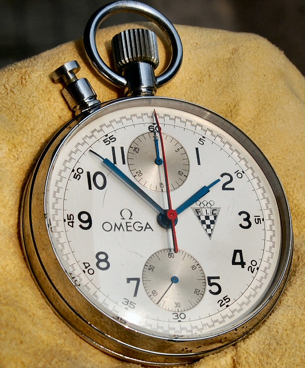

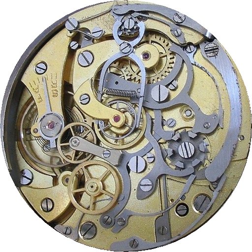

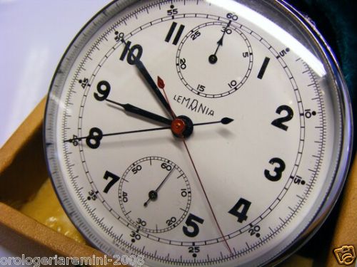

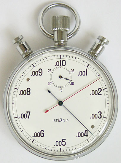

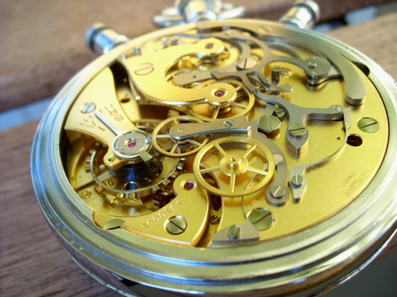

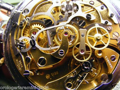

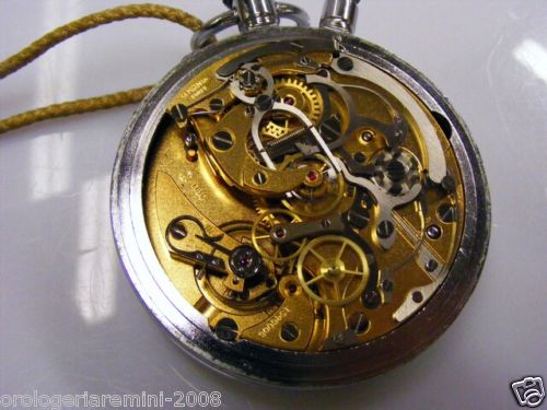

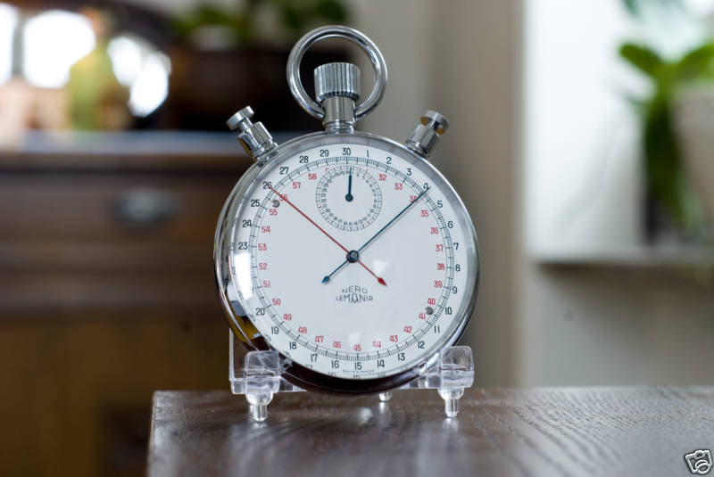

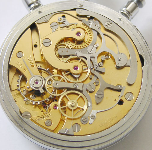

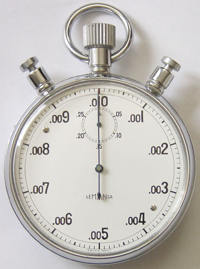

RootsThe 5498 is likely based on Cal.10004, a well known and reliable stopwatch movement from Lemania. Though cal.5498 did away with the time train, its resemblance is undeniable.
Lemania Cal.10004 (picture borrowed from PocketWatch) and 5498 side by side.
Here's a Lemania 1130, a 10004 derivative, from an italian auction.

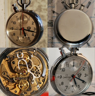

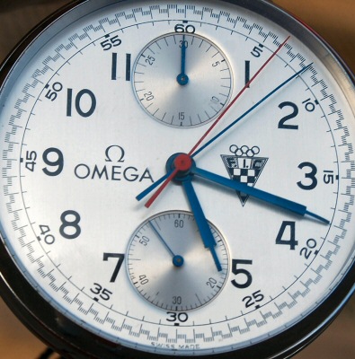

Omega cal.1132, "Federazione Italiana Cronometristi" (1965). Movement made by Omega under a marketing agreement with Lemania.

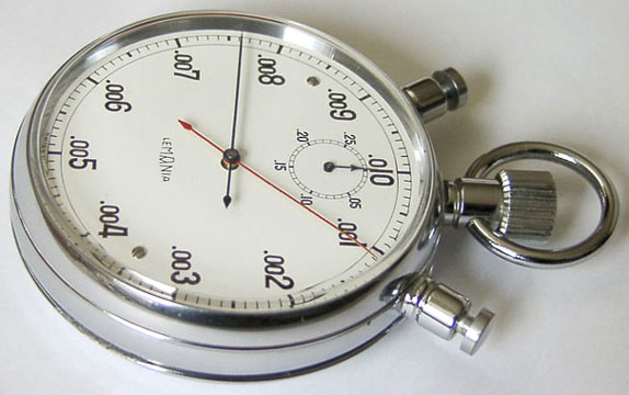

For comparison, this is a Lemania caliber 1210 with no time train. Superior finishing, off-center minute counter, 65mm chromed brass case, acrylic cristal. But it's "only" 15 jewels and runs at 18,000 bph.
Another beautiful sample of the 1210, a naval deck stopwatch (1950's/1960's) featuring a very strange dial.

How to date itThat's a tough question. However the following table may prove useful to get an approximate, to say the least, idea of when was your sample made.
| S/N | Year | notes |
| 004478 | 3Q-1956 | 15j, non rattrapante |
| 004643 | 3Q-1956 | 15j, non rattrapante |
| 006079 | 4Q-1956 | 15j, non rattrapante |
| 009400 | 1Q-1959 | oldest 30m rattrapante sample known so far, Mark Gordon's collection |
| 009791 | 1Q-1959 | eBay Latvia |
| 012318 | 3Q-1959 | boxerora.hu |
| 013065 | 2Q-1961 | eBay, Berlin (dial слава) |
| 017803 | 4Q-1961 | eBay, Ukraine |
| 020648 | 1Q-1962 | eBay, France (dial 2M) |
| 021179 | 1Q-1962 | eBay, Bulgaria (dial слава) |
| 027775 | 3Q-1962 | eBay, Ukraine (dial 2M) |
| 038323 | 2Q-1963 | - |
| 042178 | 1Q-1963 | - |
| 070676 | 4Q-1964 | - |
| 072152 | 4Q-1964 | 2M logo, screw bal., old plate, wooden box |
| 075219 | 1Q-1965 | plain balance |
| 105805 | 1966 | date from pasport |
| 126866 | 1Q-1967 | eBay, USA (dial 2M) |
| 165509 | 3Q-1967 | - |
| 178860 | 1Q-1968 | 60min, screw balance |
| 217569 | 3Q-1969 | new plate 8281 |
| 227365 | ??? | first sample w/o year, eBay Bulgaria, wooden box |
| 359067 | 1973 | date from pasport, screw balance |
| 0017213 | 1974 | date from pasport, GOST 5072-72 |
| 0051755 | 1975 | date from pasport, GOST 5072-72 |
| 0241876 | 4Q-1979 | date from pasport, GOST 5072-72 5498mod. 60min |
| 0311912 | 1981 | date from pasport, GOST 5072-79 |
| 0390648 | ??? | date uncertain, attestat says 1989 |
| 0455590 | 1984 | date from pasport, GOST 5072-79 |
| 0459093 | 1984 | date from pasport, GOST 5072-79, Nuno, este é o teu :) |
| 0481802 | 1985 | March'85, date from pasport, GOST 5072-79 |
| 0509236 | 2Q-1988 | date uncertain, 1 min 54601 (Mark Gordon's) |
| 0530252 | 1988 | SLAVA latin, movt SU |
| 0535437 | 2q1986 | date from pasport |
| 0542311 | 4Q-1988 | date from pasport, movt SU 5498 smooth bal,slava, new plate |
| 1056169 | 1988 | date from seller |
| 5808646 | ??? | latest sample known so far, early 90's, orologiko.it (Armando, "Crono") |
